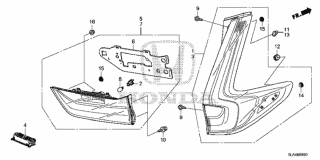

    Hi sir, yung mga brake lights at turn lights ay LED na, kaso integrated unit sila. Meaning walang parang "bulb" na natatanggal para mapalitan, as an assembly sila pinapalitan. For diesel variants, all-LED ang buong headlight-turnlight-DRL combi:
    For gas variants, halogen yung low (#5) at high (#9) beams, pero LED yung DRL at turnlights:
    All models have an LED combi (#1/3) brakelights, taillights, and rear turnlights. Reverse light (#8) lang ang hindi:

    Actually sa Honda US yan sir, so hindi exactly the same with ours with respect sa engine.
    Pero for body panels, pwede nang gawing reference, nabaklas ko na actually buong tailgate panel ko by referring to US diagrams. Also did some preliminary / exploratory baklas sa A-pillar panels & dash panels para sa next project ko na dashcam installation (hardwired, ayaw ko nang may nakakabit sa aux socket) [emoji28]

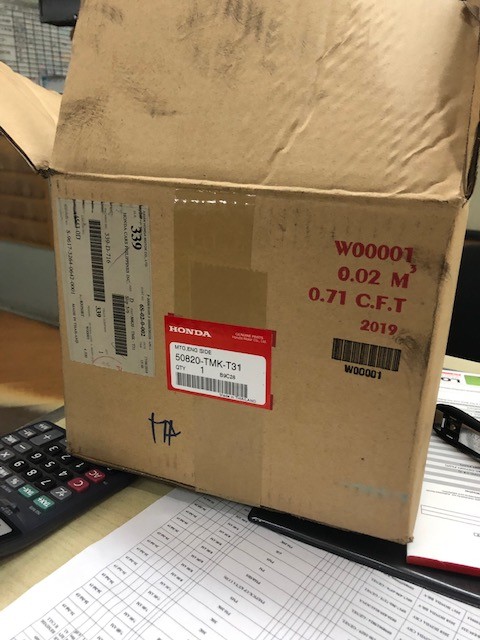

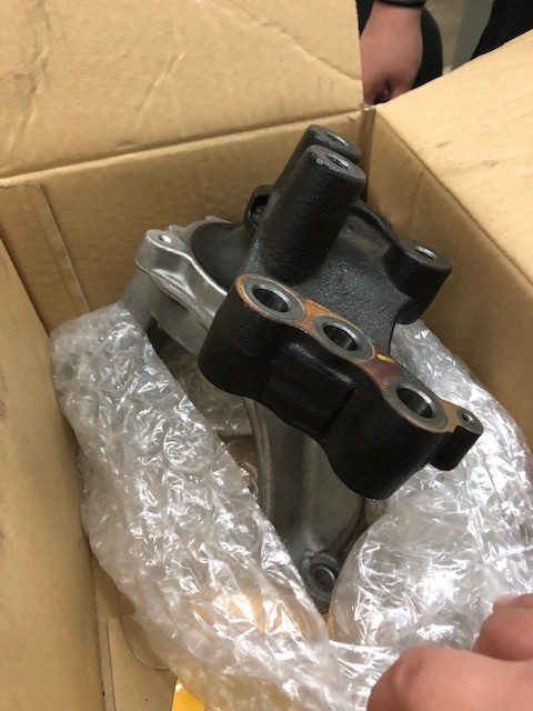

    Finally tumino na yung unit! Replaced engine support na then ibibigay daw sa planta yung part ko for evaluation.
    Here are some pics:
