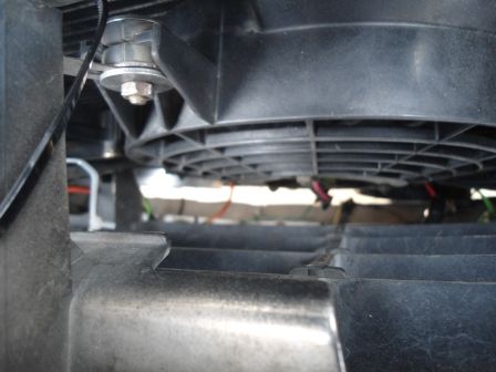

    just finished upgrading and modifying the inter cooler of our eve... D.I.Y lang... project ng namin ng father ko..
    i was also able to fit two large high power aux fan sa harap condenser dahil lumuwag na,

    Miko, hindi ba delikado yan at baka tamaan ng bato?

    #1513
    Lagyan dapat ng guard yan. Wasak yan sa bato.

    #1514
    di naman...hahaha... lifted na kasi yung eve ng 2 inches... pag sa personal hindi naman ganun ka baba, pero baka lagyan ko din mesh sa harap just in case....
    2 feet from the ground yung intercooler....

    #1515
    Quote Originally Posted by miko101130 View Post
    Pa fabricate ka lang ng mesh bro, para safe.

    pretty cool mod. lamig sigurado ng charged air intake mo nyan.
    nice upgrade sir.
    newbie question, may effect (decrease/increase) ba sa turbo lag?

    #1518
    for the lag sir, walang increase,,,, Bar and Plate design ginamit ko tapos hindi malaki masyado yung pinalit para no air pressure loss at resistance...
    maintain lang yung air pressure, and difference eh mas malamig air going to engine... less effort sa makina plus more power

    Sir question pag nag palit ba ng aux fan na kasing laki ng sa inyo maingay ba? Pailt din ba mg relay at fuse? TIA
