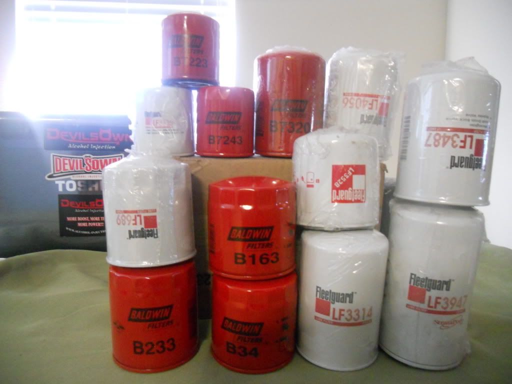

    Will upsizing to a longer and a bit wider (rubber gasket same diameter) oil filter affect the oil pressure negatively ?
    I have gone from Toyota OEM 90915-YZZD2 to LF3487 (present) and soon LF3947.

    Is it for d4d engine? B178 baldwin is what you want

    Quote Originally Posted by TheGreenThing View Post
    Its for the VVT-i. There is a ton of space down there. Fleetguard is still to go for me in this my case.

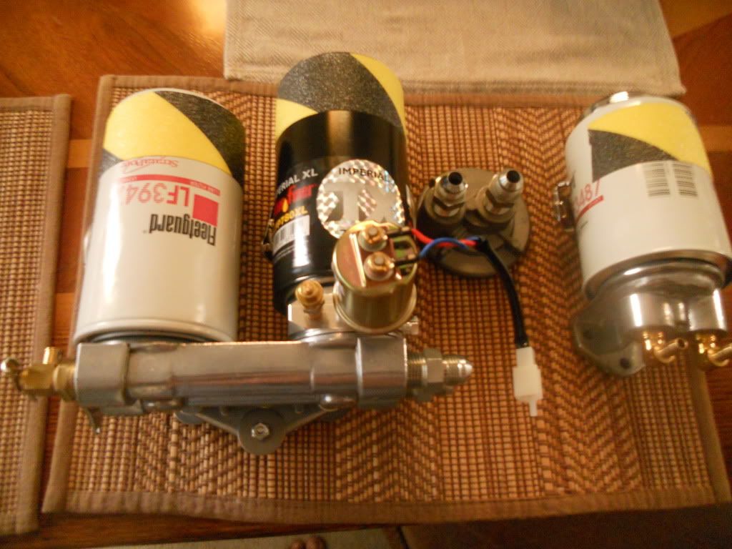

    This one's my photo.
    photo credits to devil doc
    LF3487 on the right. LF3947 on the left.
