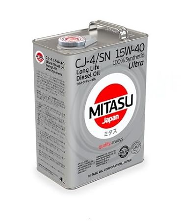

    Mitasu brand sir 15w40 - sa 2.0 honda CRV ko. kasama sya sa tuneup package yung oil sir. worry ko lang upon checking the grade of the oil- ang sabi nila it for diesel engine.
    Kaya ang worry ko ngayon sir- hindi nya kaya ma damage ang engine? thankd

    Depends on the oil. Some oils can be used in both gas and Diesel engines. They would have an API mark like SN/CF (SN if used on gas, CF if used on a Diesel). But if the oil is spec'd with API CF, API CH, API CI, etc., they're exclusively designed for Diesel engines.
    Jun 2005
    3,774
    You need to know what type of mitasu oil was used. Yung iba may gasoline equivaleny so no problem yan.

    You have to consider another vital job of an engine oil, which is to suspend combustion by-products using detergents. Gasoline and Doesel engines produces vastly different by-products. It then follows that the wrong oil can be deteimental to the engine if the detergents within the oil is incompatible with the by-products.
    ... modern oils are formulated for their intended applications. While both diesel and gasoline oils contain many of the same additives to guard against wear, corrosion, foaming and more, they also contain additives designed to manage the byproducts of combustion. Some of those byproducts change, depending on whether the engine runs on gasoline or diesel fuel. If your vehicle uses a gasoline engine, it’s best to use an oil that contains the correct additives to handle the byproducts of gasoline combustion. The same holds if you’re operating a diesel engine.
    Source: Can I Use Diesel Oil in My Gas Engine?
