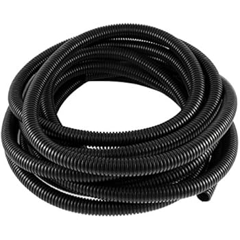

    That's and easy DIY if you know how to solder wires. Just buy a genuine wire yung Japan. meron kasi Taiwan na yung advertised
    gauge konti at manipis ang copper strands. After replacing the damaged wire, balutan mo ng flexible conduit para ma discourage yon daga kumain ng wire. Lagay ka narin ng Repellant, Dora rat killer, or yung adhesive-type rat trap sa loob ng engine bay
