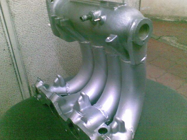

    I modify the intake manifold and welded an upswept design same length as the original D15, with out modifying the bulkhead of the Mini.

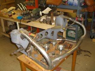

    here is the chassis I modify. Note that the original Mini suspension has not been altered. I did this project to keep my Mini more road worthy and parts availability, But I intend to keep the Mini appearance as stock as possible, to keep up with the New BMW Mini.

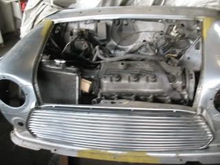

    This is the finish product! Note! no nose extension.

    1.) Performance is much better than the aging A series with stock HP of 100bhp+,
    2.) Handling is ok, no torque steer since I did not alter the Mini suspension,
    3.) Radiator comes from an automatic Civic, we did not modify anything, it fits!
    4.) it has a/c FYI.
    5.) D 15 engine is much lighter than the old iron block ng Mini.
    6.)steering we add a kit that is 30% lighter than the original Mini steering.
