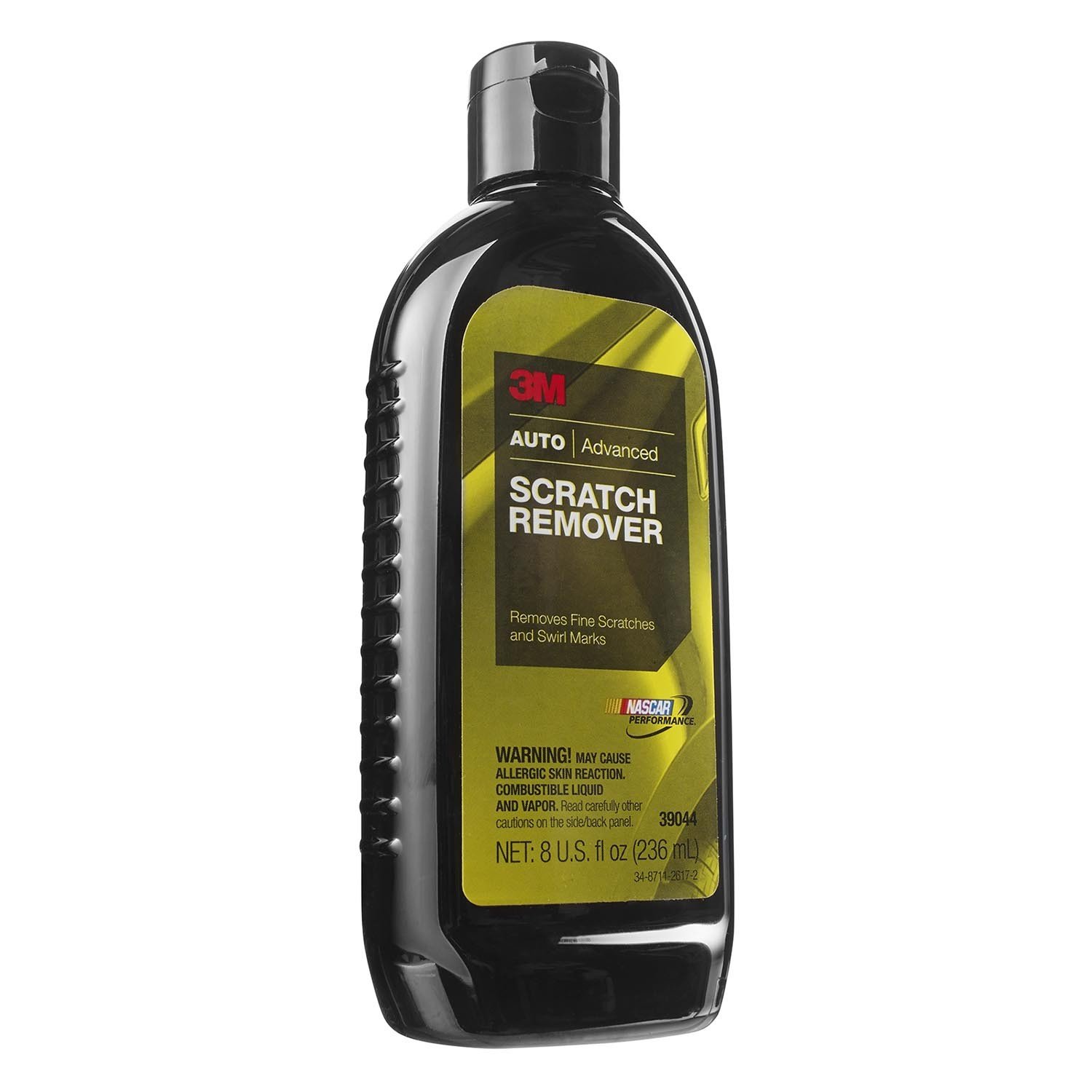

    Thanks! For the meantime though do you think 3M scratch remover might lighten up the effects?

    try cleaner wax first... tingnan mo kung kayang tanggalin pero small portion muna.
    kung hindi kaya try scratch remover pero small amount lang then pagkatapos mag cleaner wax ka ulit tapos mag wax kana.
    hindi yan kaya nang wax lang.

    Yeah, ingat lang on the scratch remover.
    Remember that underneath your bumper is plastic, black plastic.
    And it's the same color as the rubber scuff mark that you're trying to remove.
    Baka you might get carried away without knowing that you've already gone through the paint.
    14,181
    Ok thanks! For now will just use 3M scratch remover just to make it less obvious... Tapos detailing na lang later sabay na buong car...

    Try mo muna tanggalin ng WD40, then wash off with shampoo & apply cleaner wax. Wag scratch remover, masyadong abrasive yun.
