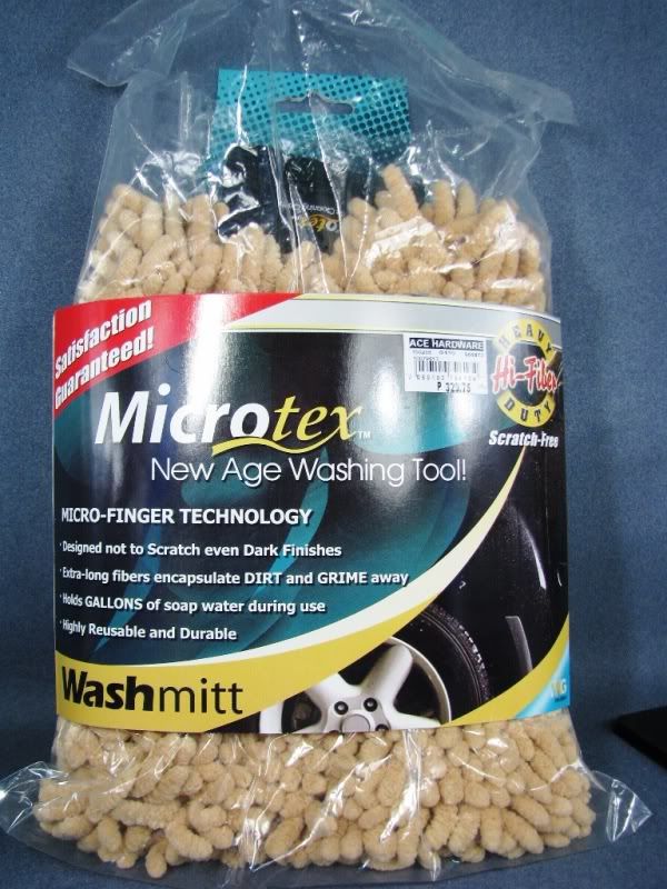

    Kasalanan ni doc scharnhorst I use microtex products as recommended by doc. It's quite liberating compared to turtle wax. It's really easy to buff off.
