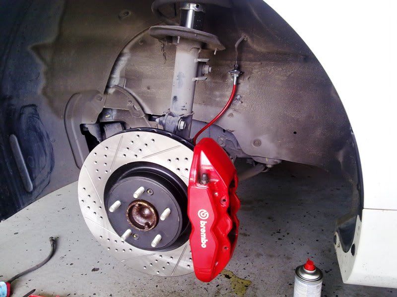

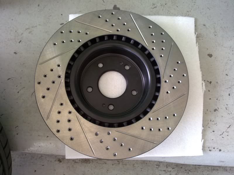

    The non-Brembo brakes are okay if you don't go racing. The stock Brembo pads, which is P34k at the dealer, is really a let down. Use it sparingly and it's all right. But use it hard and often (hataw mode, as in 180-220 kph) and it easily fades. Coming from Santa Rosa at hataw mode, by the time I reach the Alabang viaduct, may brakes start to fade and I have to cool them down. Changed to Hawk HPS and they were much better. Brakes starts to fade somewhere in Bicutan at the Skyway. Buti na lang medyo rough yung part ng Skyway sa area na yun so I really have to slow down. Decided to install ARK slotted and drilled rotos, front and rear, with steel-braided brake lines. Now, my brakes don't fade no matter how hard I use them. Some pics:

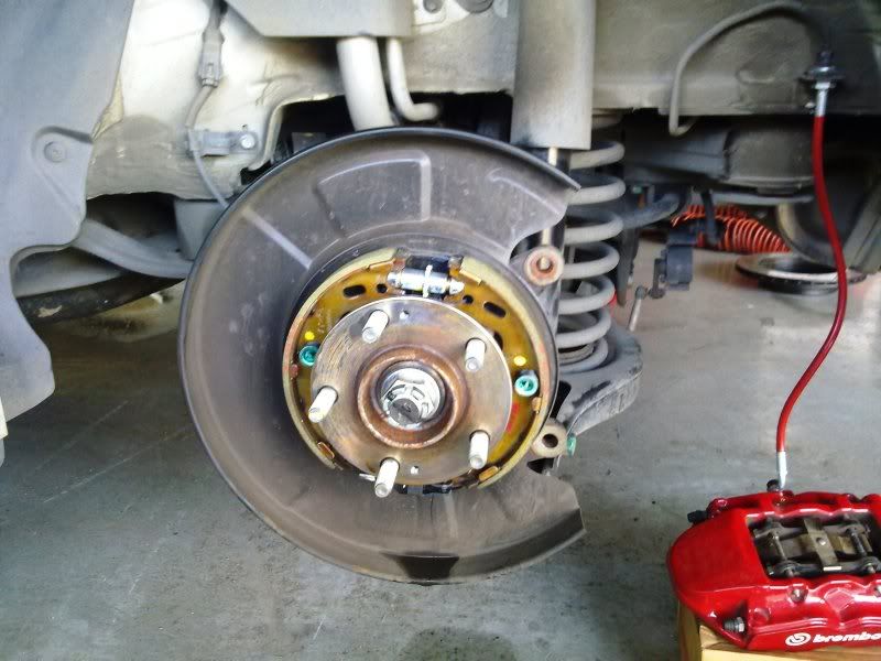

    BTW, another beauty of the HGC is that it has an independent handbrake system. The rear rotor has a small drum which is used for the handbrake. So even if your main brake fails for one reason or another, you can still stop the car completely. Of course, since the brake is quite small, it will take quite a very long time. Still, it is better than no brakes at all.
    See pic of handbrake:
    Apr 2011
    151
    Great info sir.
    Suspestya ko drum brakes nga ang hand brakes ng GC. Buti naman. I hate yun mga integrated handbrakes sa calipers. Upgraded my lancer from rear drum to disc. Nag sisi ako eh. hahaha!
