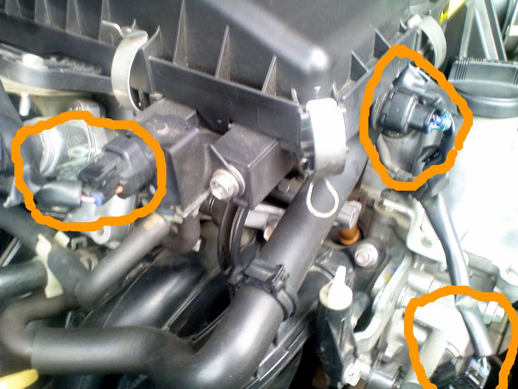

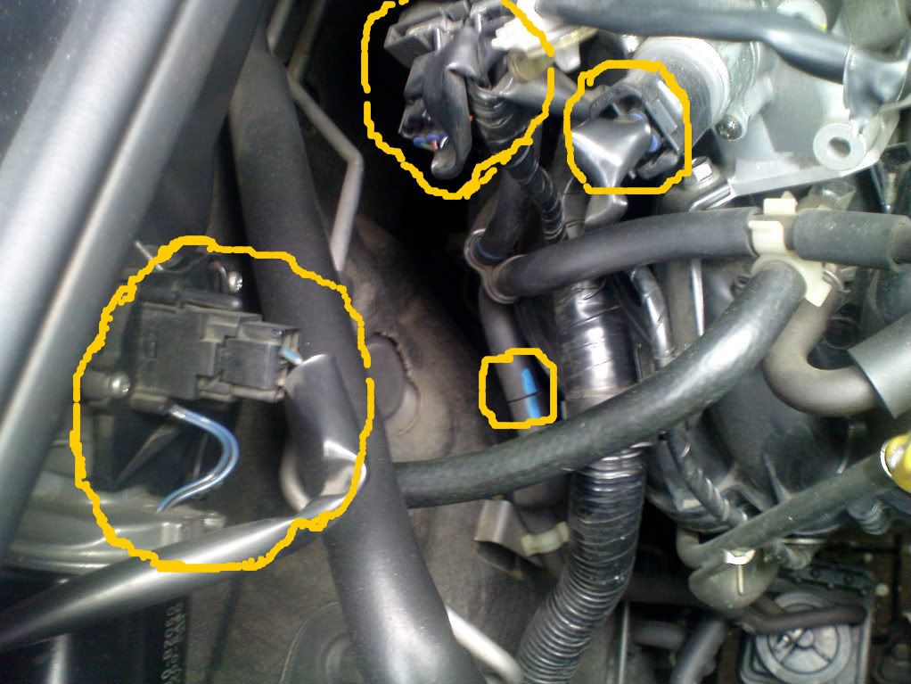

    I took photos of the wires sa engine bay I noticed na yung mga end exposed. Sa inyo din po ba the same? Puroy mentioned something about "heat shrink rubber caps" meron ba yung sa inyo???
    Pa-post naman ng pics nung sa inyo. Meron na bang nag DIY nito? Please share.
    After the MIL problem plan ko sana takpan yung mga ends para mas secured. I bought an electrical tape today but hindi ko pa nalalagyan. Is it safe to cover the end ng wires with electrical tape? ganon kasi ginawa sa casa.
    Can someone suggest a better way to secure/protect these wires without voiding the warranty.

    Aren't they sealed by the blue parts as the wire enters the connector?
    Heat shrink can be bought sa raon. It's just like sealing those mineral water caps. Just put the heatshrink in the desired area, blow with a heat gun and the heatshrink will shrink and conform to whatever you intend to protect. Look under the dash, heatshrink is the OEM method of 'taping' wires. You don't see them using electrical tape in the factory.

    My theory is this: since naka-ilang balik na sa casa ang tatlong ACP Members na nagkaroon ng ganyang problem, siguro nahugot ang mga wires dahil sa bara-barang trabaho ng mga casa mechanics. They might be pulling on the wires instead of the plugs when they unplug the sensors.
    Hindi pala nila ina-unplug, ina-UNWIRE pala nila.

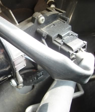

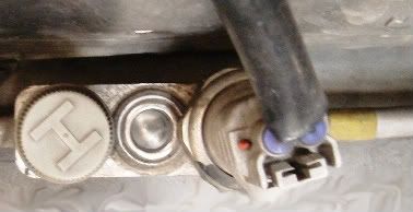

    buhayin ko lang....kulit ng kulit kasi wifey ko sa "exposed wires"
    korek si sir otep dito na sealed(blue) parin ang mga wires, no exposed wire.
    kung nahugot ang "blue", ibalik lang eto, like what happened sa plug na nakasaksak sa flter.
    the black tube or jacket is additional protection and no need to add shrink tube, or if lalagyan pa ng shrink tube, piliin lang ang mas mataas na temp na kaya sa init ng loon ng engine bay.
    the wire insulator can withstand heat but could become brittle after 10years or overheat occur inside engine bay.
    mas gusto ko na ganyan para makita ko kung may connection paba o wala...
