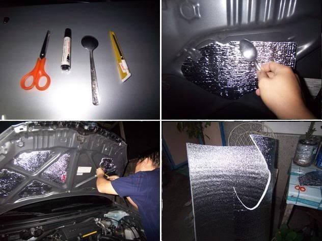

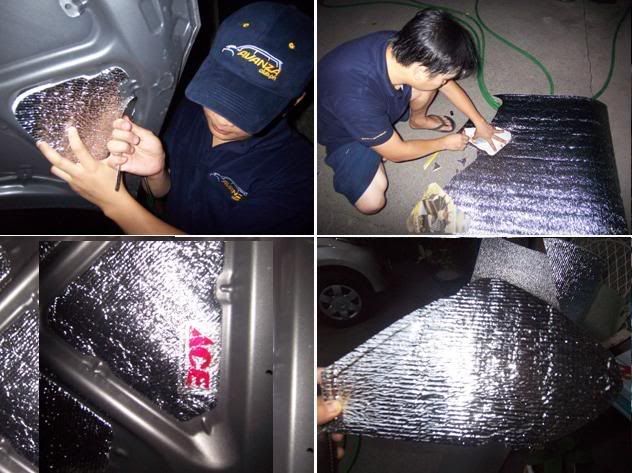

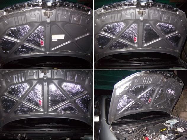

    Hi guys,
    Instead of buying the engine hood cover which would probably cost more than 1k pesos, here is a DIY of engine hood cover.
    Enjoy.
    Purpose:
    - Improve sound proofing
    - Protect hood paint from extreme heat of the engine
    - Looks neat.
    - (....any inputs from the forum)
    Material:
    0.5 Meter of Home insulation with 10mm thickness (got this from ace 1M for 99.9 pesos)
    Tools:
    Cutter
    Scissors
    Old news paper (for molding)
    Spoon (this is no mirienda use )
    Marker
    The Making
    1. Make the mold from old news paper using scissors and marker
    2. From the mold, cut the insulation material using the cutter
    3. Then installed it using the kitchen spoon (which i found easier)
    After the Tagaytay Fun run, can't stop thinking of doing it so here i am...
    The progress
    Continue.....

    nice job sir, nakaipit lan po ba yan sa X-frame ng hood? another thing sir ganda ng avanza cap at shirt nyo sir, san ba makakabili nyan? info naman sir...thanks
  15. #15
    Join Date
    1,452
    Default Re: Avanza DIY (Engine Hood Cover - under)
    Quote Originally Posted by arki69 View Post
    Base on the picture, yes nakaipit lang yan sa x-frame at nasa iyo yan kung gusto mong gamitan ng pandikit kapag ng DIY ka...
