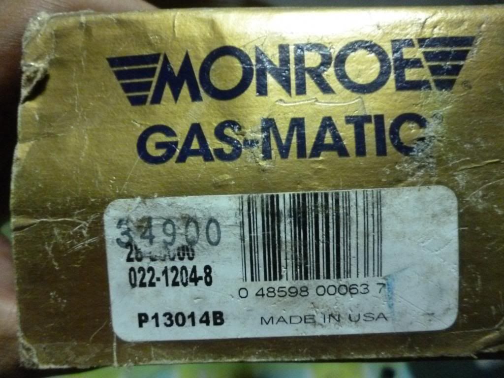

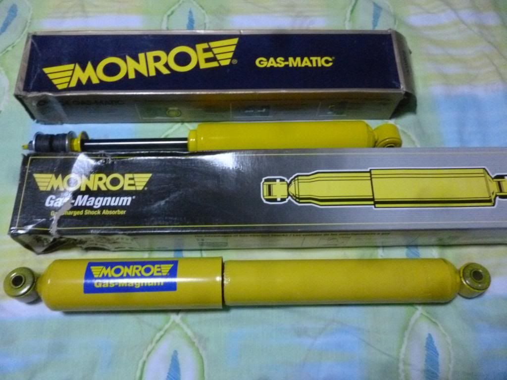

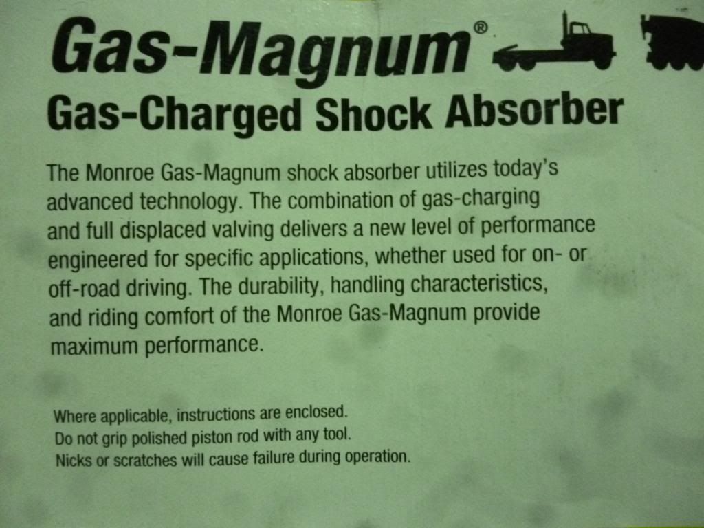

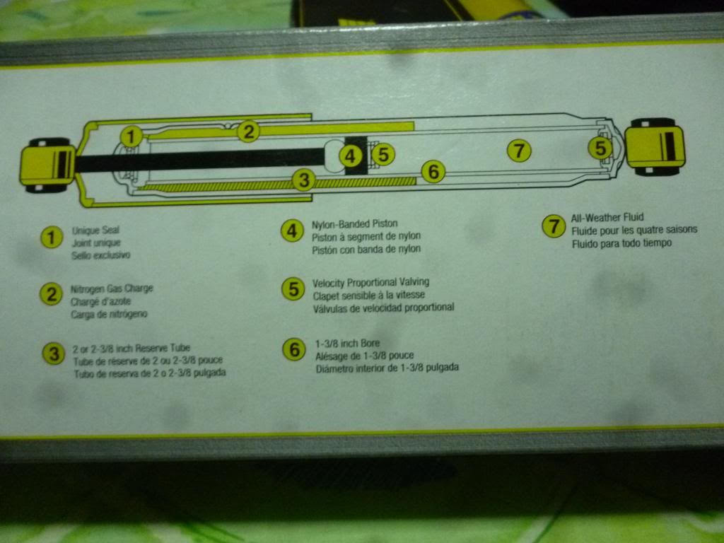

    2" longer shocks by Monroe:
    Front:
    Rear:
    All together now:
    hi magkano yung ganun shocks?no need na for new springs?
