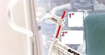

    baka nga gawin ko is ibaba ko na lang ung stem tapos itaas ko naman ung isang spacer,2pcs na 1" at isang maliit na carbon spacer un nilagay ko, sakto naman sya wala na kitang tube ng fork and ung cap ng headset flat naman sya...

    Huwag manghinayang sa stem, pinuputol talaga iyan
    hehe maskina aku manghihinayang dyan, you might mean steerer tube ng fork kasi yung stem pagpinutol di namagagamit
    *iskulbukul basta rule of thumb nalang, put 2 inches of spacer at the bottom of your stem tapos extend 1in of spacer at the top, you can play around with that range of height na, eto edited your pic
    yung sobra na steerer tube above the 1in allowance you can cut na
