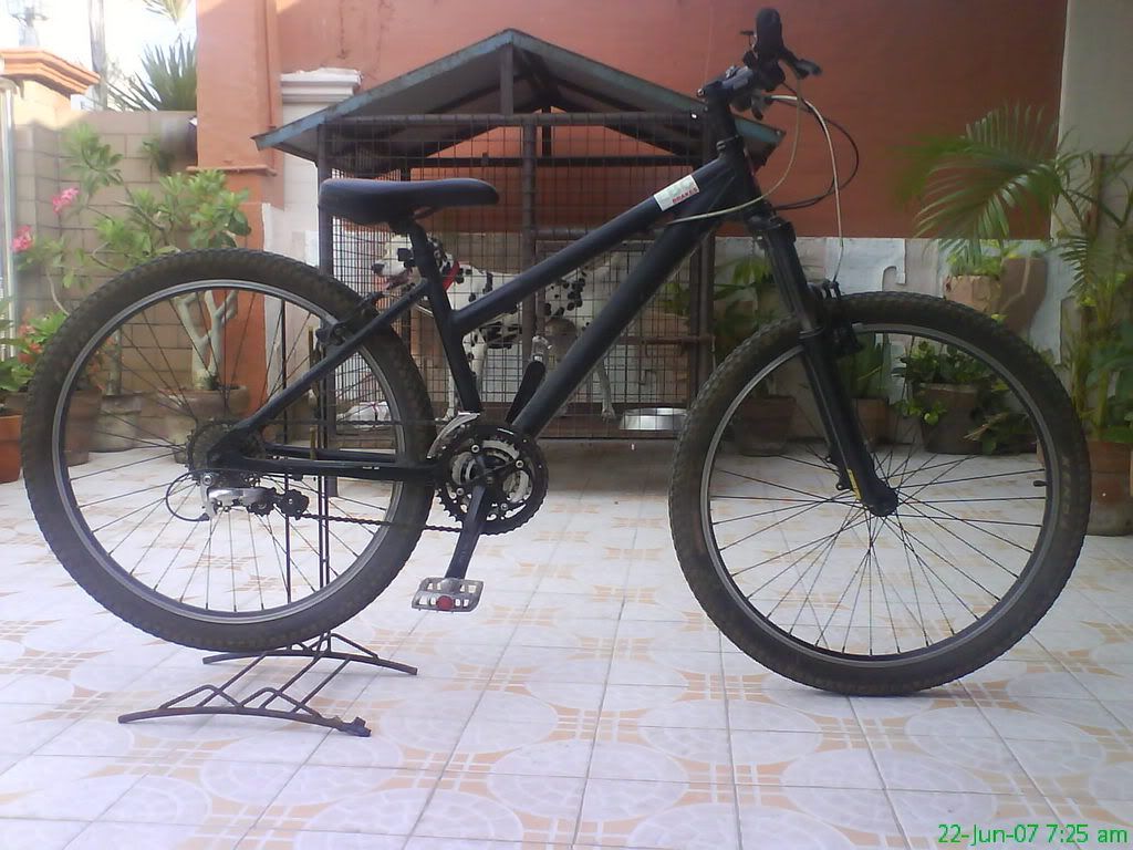

    Nice bike, What RST is that? Is it built bike?
    Ei guys here is mine by the way
    My Trials, Street, Commuter bicycle

    thats the shortest rear derailluer cage ive seen hehe

    Its from a Roadbike hehehehe
    Tiagra.
    Iwas chain slap!

    maxb.,
    paano mo ginawang ganito yung derailer mo?
    Attachment 8730
    binatak mo ba by shorthening the chains?
    hindi prone kumalas?

    Theres Really nothing Special to it
    My Rear Cassette is the SRAM PG990 (9speed) with 34 teeth for the Lowest Gear
    And Truvativ Five D Cranks (Square).
    I Used a Shimano Tiagra 9speed Road Bike Rear Derailluer.
    The reason for that is so I can do Urban street Jumps sa mga humps, Basic bike trials, without the chain slap of the rear derailluer. (Beginner din lang ako sa ganitong bike discipline)
    Road bike part got short cage hehehehe
    Disadvantage is that i cannot combine the biggest Cassette which is 34T and the biggest Chainring (Plato) 44t. But thats just it.
    Thats the reason why the RD is so stretch in the photo.
    Maybe if Ihave 32 on my casstte it wont post a problem
