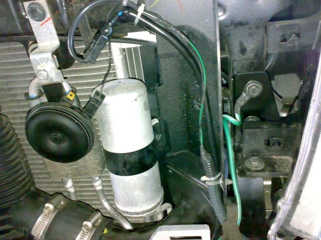

    Already finished with DIY additional grounding using AWG10 stranded wire, 8mm eye terminals, and heat shrinkable tubes. Tis has long term benefits like what ive experienced from my old rides. Just be careful with the battery-remove the negative side before doing electrical jobs and if possible connect the chassis to earth ground to discharge any static buildup that may damage computers.
    http://i289.photobucket.com/albums/l...hassis_Gnd.jpg
    http://i289.photobucket.com/albums/l...os/Bed_Gnd.jpg
    http://i289.photobucket.com/albums/l...s/UnderGnd.jpg
    http://i289.photobucket.com/albums/l.../SocketTap.jpg
    http://i289.photobucket.com/albums/l...Addtnl_Gnd.jpg
    http://i289.photobucket.com/albums/l.../Re_wiring.jpg
