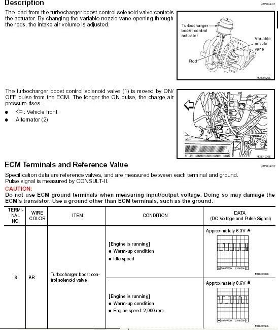

    *cydepx44 - Turbocharger mod also caught my attention some months back, but i can't find successful results made by other owners.. Maybe you could start the lead or some turbo expert might be able to help us .. So far based from market availabilty, most feasible mod is chip + alcohol injection.
    Did some research with Honeywell site there are numbers but not sure if its the exact part for the year model. Garett
    141PS Model GT2056V PN#734868-0001 OEM# 14411-EB320
    174PS Model GT2056V PN#769708-0003 OEM# 14411-EC00C
    ref http://www.turbomaster.info/aplicaci...rismos/nissan/
    As per your request here are some details from manual, difference of 4x2 to 4x4 TC. I guess turbo behavior can be altered by varying frequencies in the boost controller (engine communication controlled by pulse width modulation) existing chip upgrade does this job already.
    Main difference are Water-coolant piping, Turbo size is still the same(can somebody verify this on actual?), from pics impeller housing for 4x2 is beefier.. Don't know though if VNT specs are different but from Honeywell site its the same banana..
    Coolant lines for high variant must be due to higher operating velocities requiring more heat dissipation.
