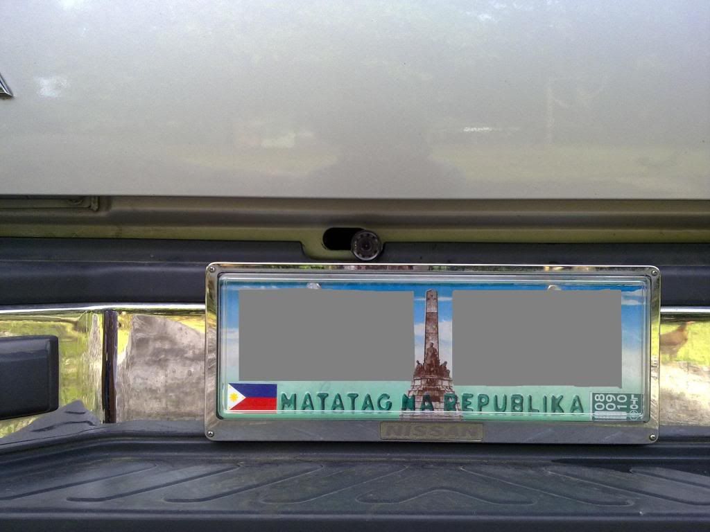

    How to run a wire from engine bay to cabin of D40 Navara
    Share kolang, i rectified my backing camera problem(got busted 2wice)-found out the installer wired directly to live(green wire)
    http://i289.photobucket.com/albums/ll219/jatcos/Cam_wrongtap.jpg
    thats why camera is hot even when key is off. Original wiring was from console, run to the sidings, then through the backseat-theres this drafter ducts (hole with rubber flaps as one-way air outlet) the wires was run from this hole to the rear of the bed. Door closing sound was not as solid as before when they run this wire thru the drafter ducts so i routed the wire to the engine bay following the other wires going to the bed. Also installed additional grounding wire for the front console, extra RCA cable and 2-#14 auto wire, 1-as spare. Wired the HU with relay and manual switch so that i can turn on the rear camera even when vehicle tranny is not on reverse
    http://i289.photobucket.com/albums/l..._separator.jpg
    http://i289.photobucket.com/albums/l...rubber_cap.jpg
    http://i289.photobucket.com/albums/l...rom_inside.jpg
    http://i289.photobucket.com/albums/l...ubber_plug.jpg
    http://i289.photobucket.com/albums/l..._with_tape.jpg
    Relocated camera -
    http://i289.photobucket.com/albums/l...cos/Camera.jpg
    http://i289.photobucket.com/albums/l...os/Camera3.jpg
    Re-wire HU
    http://i289.photobucket.com/albums/ll219/jatcos/HU.jpg
    http://i289.photobucket.com/albums/ll219/jatcos/HU2.jpg
    http://i289.photobucket.com/albums/l.../remove_HU.jpg
    http://i289.photobucket.com/albums/l...nt_removed.jpg
    Sorry for the long post .
