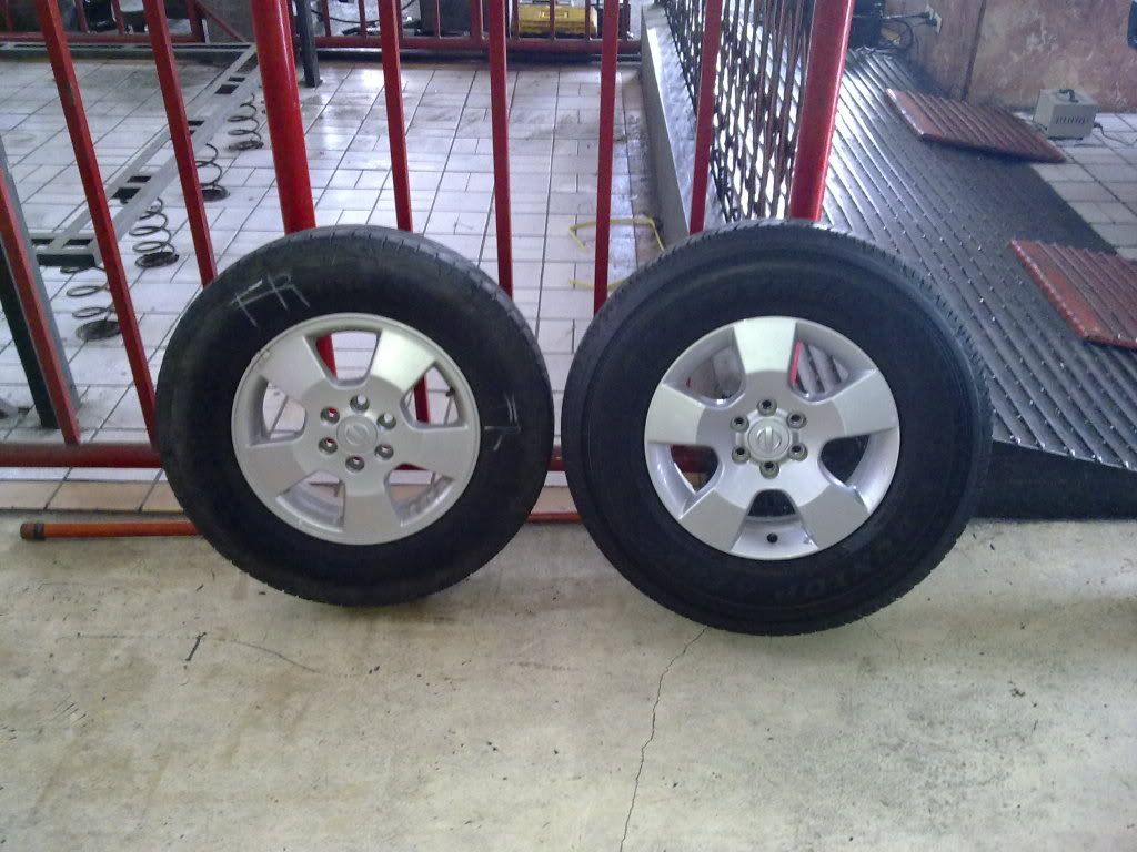

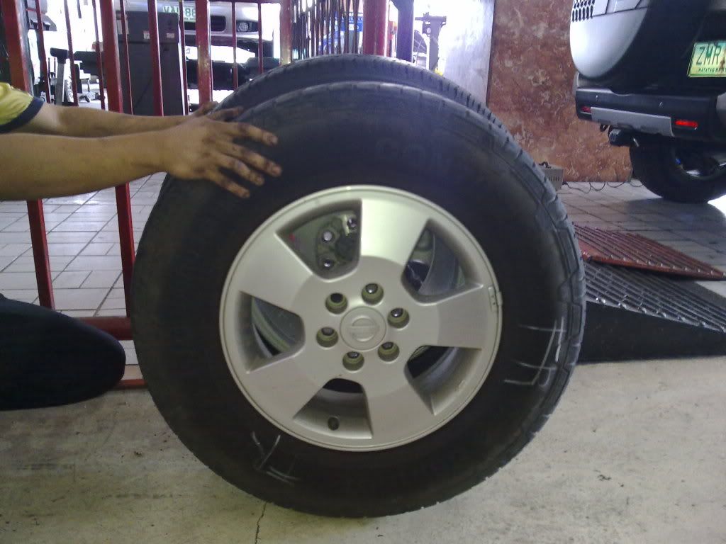

    Just want to share some update, medyo sinipag..hehe pampa bilis ng thread..
    http://i289.photobucket.com/albums/l...tireheight.jpg
    http://i289.photobucket.com/albums/l...ireheights.jpg
    http://i289.photobucket.com/albums/l...ng4x4tires.jpg
    Replacing stock2stock 4x2 to 4x4 rims/tires, overall performance hmm..
    - Ok ang dunlop tahimik pero sana hindi bumukol katagalan jst like my bad experience.
    - Tire/ride height increased 1" at lumabas ng 1" sa rear fender. Front sakto lang sa fender at mudflaps. Minimal ang dirt effect sa rear because of tires design.
    - Nabawasan ang accuracy ng speedmeter, yun 100kph lumalabas around 110-115kph(tach as reference) kaya pala parang lahat ko nalampasan sa expressway.
    - Approx 8kgs ang difference ng stock 4x2 sa 4x4 tires so im observing for effects on steering adjustment and suspension parts..Overall mas gumanda ride.
    - FC remained at 10-13k/L

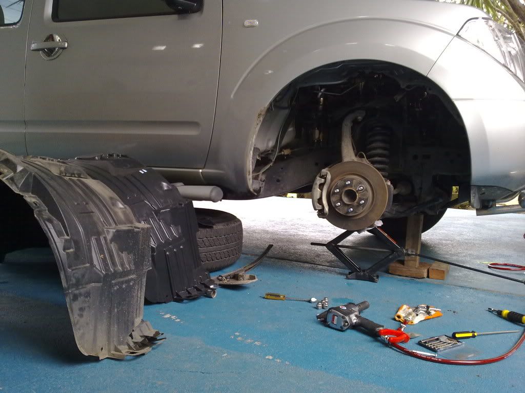

    Replaced my damaged(accidentally hit a big dog) fender protector. http://i289.photobucket.com/albums/l...eplacement.jpg
    Labor charge at casa is 1.3k and will take 2-3hrs to install. They failed me since 2-days nasa loob ang car at hindi nainstall even after several ff-up and reminder, kaya sa inis ko pinull-out konalang ang part..tsktsk. bad service. Took me 30mins to install using home-garage tools (including linis fender parts at balik ng tires) no sweat..
