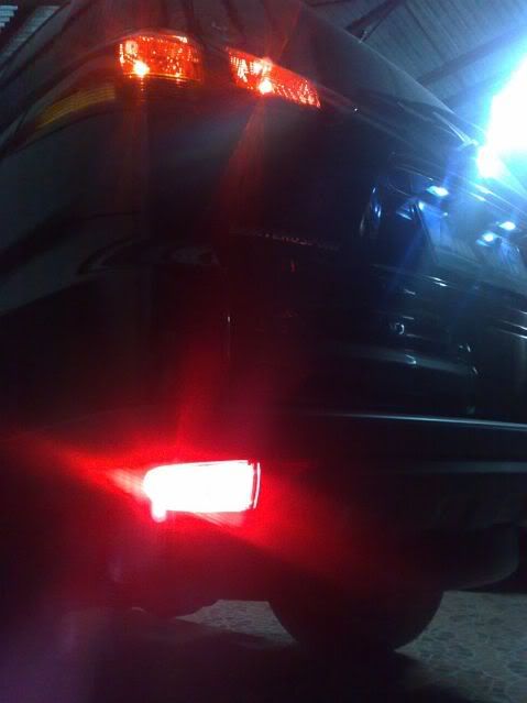

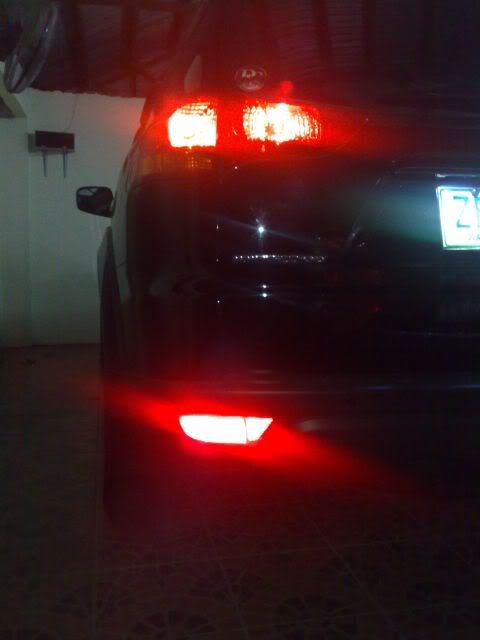

    Quote Originally Posted by JJGF View Post
    naalis ko na yung 2nd screw bandang 1:00 binaluktot pa namin yung screwdriver para pumasok hehe
    pero may 3rd pa pala! magkaiba yata tayo hehehe nasa 10:00 hindi maabot kahit anong tools.. kailangan alisin pa bumper
    hi sir! i've also inquired about the rear foglight before... and the SA said hindi kayang alisin yung housing unless baklasin yung bumper.
    so what i did was changed the left bulb to a red 21W polarg hybrid bulb then tapped it to the park light... pansamantagal na rear fog light.
