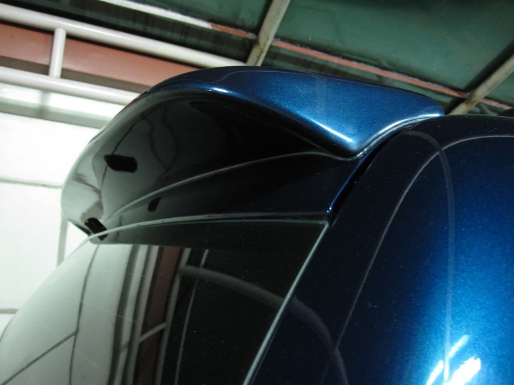

    heres my DIY spoiler and rear tailgate garnish install using white silicone looks neat naman
    Hi sirtj, is there a way to apply the silicon without it being seen? or is it oem-like to show it (like the corners in a glass aquarium)? that's the advantage of double-sided tape, invisible but not strong enough. did you still use screws to keep the spoiler in place? my installer is suggesting we drill 2 holes for screws.
    we installed the read side skirts and mudguards, used silicon paste but is can still be seen even on a silver finish. (to those who have installed these before, did you still use the rubber strip moldings that was supplied in the kit? (parang madaling matuklap).

    thanks noobskie. clean is all im really aiming for
    thanks also toots_s. youre right though, its scary doing diy especially when you have to drill holes or permanently change something on your car. i guess you just really have to do your homework and know what you want before anything else to make sure youre doing things right
    RevD, i actually dont know how OEM is installed. im guessing its basically the same way coz when the casa installed my tailgate garnish (which i got OC about and did on my own) they were gonna put silicone on the edges aside from the double sided tape. and yup i still use screws on the spoiler. that really is the main thing holding the spoiler in place. i think the main purpose of the silicone is to waterproof the install while the double sided tape acts like a gasket.
    now if theres a way to put silicone without it being seen? unless you put it in the inner lining of the double sided tape, i dont think so. coz the double sided tape is already near the edge of the spoiler contact surface.

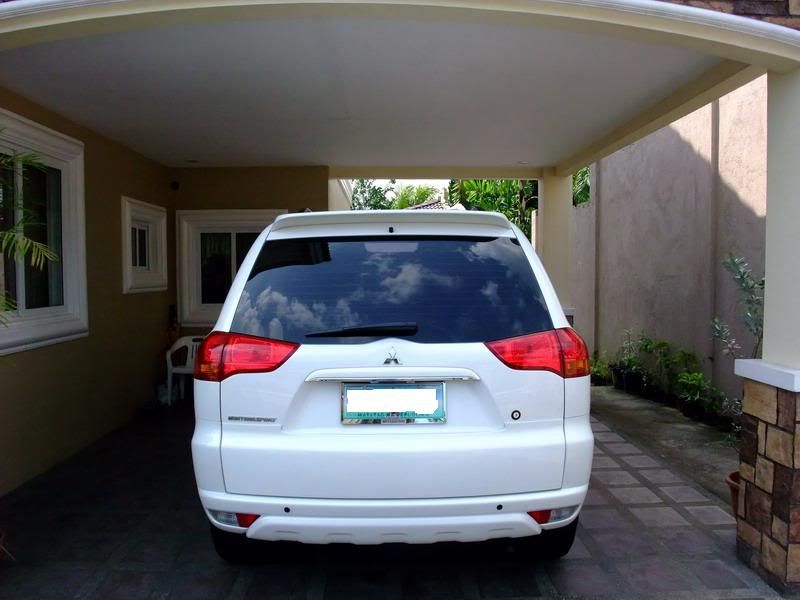

    it took 4 days to paint the front chin, rear bumper and tailgate cladding of my ride, excluding the waiting on weather time. mabuti nalang the paint shop owner is very OC and keeps on repeating until his painter got the color right. sample pic below, but with my low tech cam the pic won't do justice.

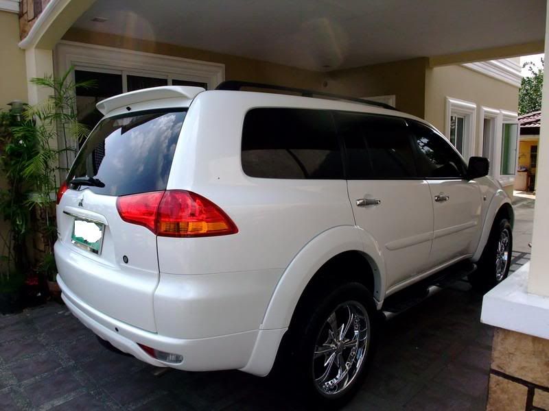

    a new look of Montero GLS he he he
    Front Bumper
    Rear Step Bar

    uhm... sir, what is the rear step for if the 3rd row seats are front facing?
