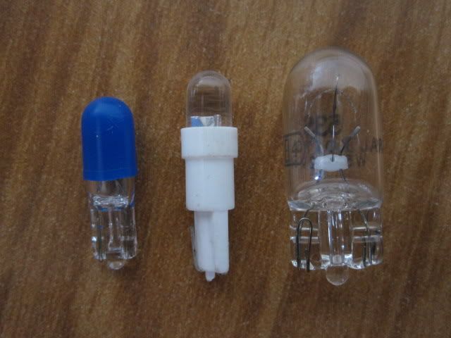

    heres a picture of the small LED bulb that is used for the aircon and the bottom right part of the speedometer
    the actual bulb is on the left and for size comparison, the peanut bulb is on the right
