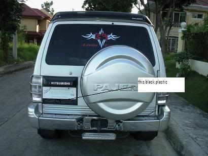

    Quote Originally Posted by janrye26 View Post
    what do you call this black plastic sa plate number banda?
    plate stage ata ang tawag diyan.
