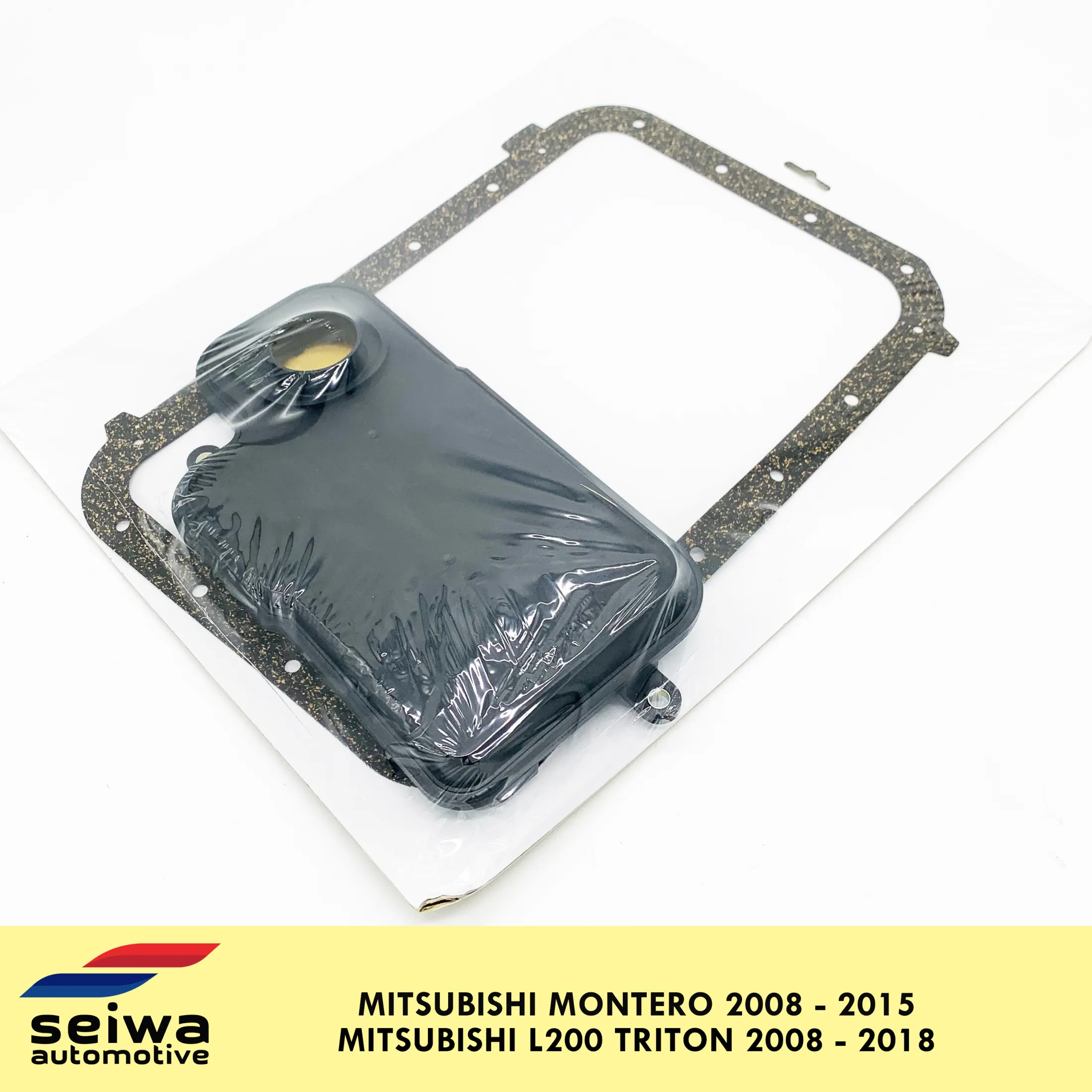

    agree with others na better palitan na ang atf at filters. if not keen on changing then at least replace the filter and top-up sa proper level.
    Sent from my SM-G960F using Tsikot Forums mobile app
    I'm sorry for the ignorance, aside from ATF, you mentioned may corresponding filter also that needs changing?
    Thanks
    Thanks
    Sent from my CPH2043 using Tsikot Forums mobile app
    Yes, may filter din sa oil pan ng ATF.
    Thanks
    yes, may filter siya. btw, if you're near Manila area, you may want to have your unit service in Zix performance shop, you can search sa waze though by appointment na sila now...
