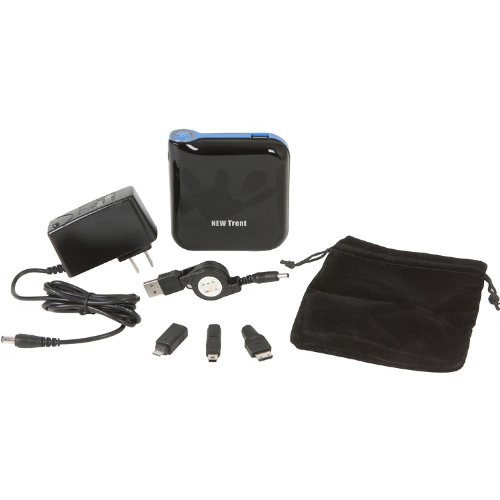

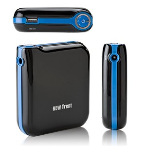

    Can also try this. Dunno if this also available locally.
    New Trent Extreme Pack IMP1000 11000mAh External Battery pack for Apple iPad, iPhone 4G 4, iPhone 3G 3GS, iPod Touch (1G 2G 3G), Motorola Droid X Eris, HTC EVO Android Phones, Blackberry (Curve, tour, storm, bold) Black color New

    29,354
    Amazon.com: New Trent Extreme Pack IMP1000 11000mAh External Battery pack for Apple iPad, iPhone 4G 4, iPhone 3G 3GS, iPod Touch (1G 2G 3G), Motorola Droid X Eris, HTC EVO Android Phones, Blackberry (Curve, tour, storm, bold) Black color New: Electronics
    If the iphone's problem is just the battery getting old and needs replacing, having an external battery pack is just like having your iphone on lifesupport, it would not solve the original problem.
    Best to have the original battery replaced and have the system checked for suspicious softwares as well.
