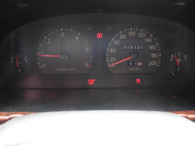

    as per request, here is the rpm reading on our carnival with a/c on.

    SIrs Josiel & Bench:
    Thanks to your replies guys, it was a great help. The current setting of my idling is set at 800 RPM without aircon and it falls to 500 RPM w/ aircon on and further drops if you put the shifter into "D" with your foot on the break pedal. At this setting, the engine vibrates wildly and it was quite annoying, to offset this i'm adjusting the RPM of my vehicle thru the choke knob located beside the hood release latch. I'll have the idling adjusted immediately similar to sir bench's. I assume that the idling of your car without aircon is set at about 1,000 RPM?
    2,639
    #1767
    looks like somethings really off with your idle speed setting.
    on ours, w/o aircon its at 950 rpm. barely touching the 1 thousand rpm mark.
    when i put it to drive, approximately 900 rpm.
