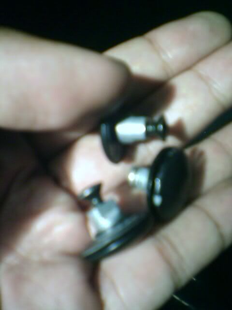

    Got locked out of the Van just last holy week and all of my spare keys are inside. it was already late, so the locksmith i knew is already sound asleep. instead of breaking the glass, we decided to saw off the "buttons" that holds the rear quarter glass.
    Had to run with packaging tape covering the broken window. To my surprise, Casa (Signet Distributors EDSA & Kia Motors Marikina) and even Columbian Motors does not carry this specific part. Also tried Auto Supply but still no luck. finally got hold of them through an Auto Glass Shop in Banawe for 50 pesos each.
    btw heres what im talking about:

    Sorry for the crappy pic. cam phone kasi.
    the first pic is the torn drive shaft boot of our carnival. being repaired at Zee Carplus
