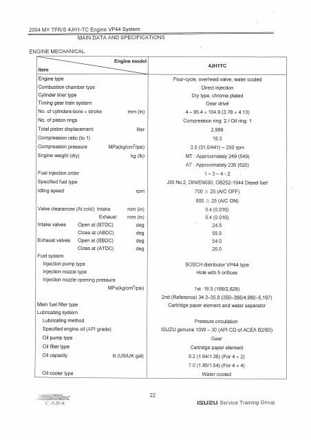

    hi,
    need everyone's advice.
    does anyone know the valve tappet clearance of the 2004 dmax 4JH1-TC engine?
    and other technical information on it correct adjustment.
    Is there a non-casa shop that knows the correct data to adjust the engines' valve clearance?
    tha nks

    Hi Kurt! I got this from my copy of the official Service Training book. I think the valve clearances here are the ones you are looking for:

    Dear Memphis,
    Thank you for the info. I visited isuzu rizal and valve clearance service is around Ph800.
    With the information you gave i can quiz the mechanics if they actually know the correct valve clearance value.
    Im having that service done because i havent done that for about 40,000kms na. Hope it makes the engine run more smoothly and quieter.
    thanks again.
