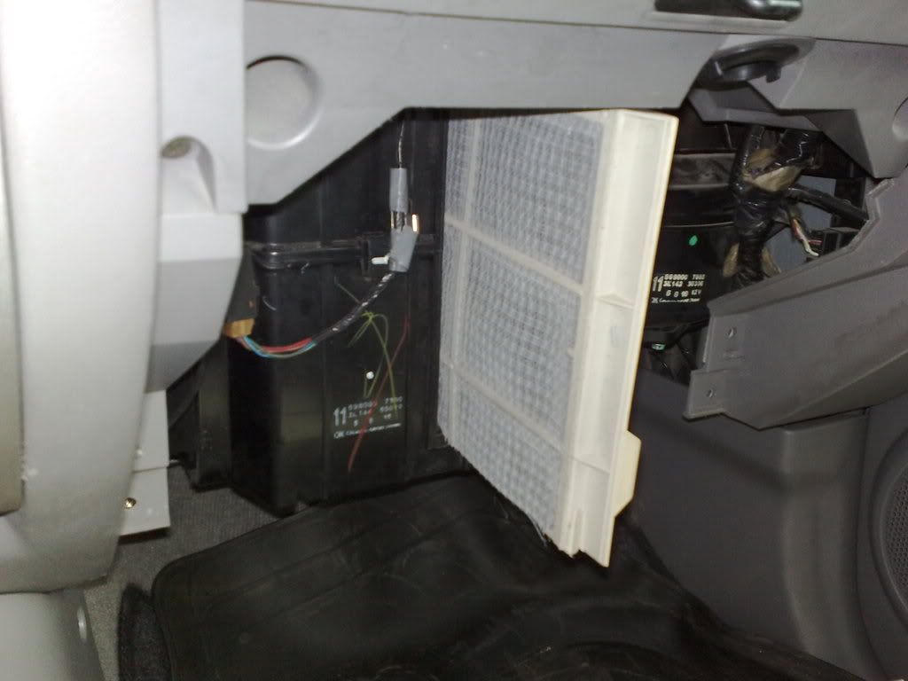

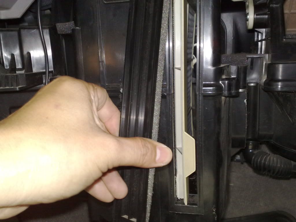

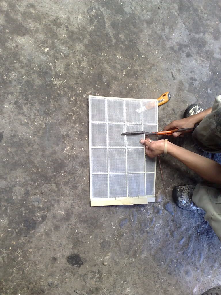

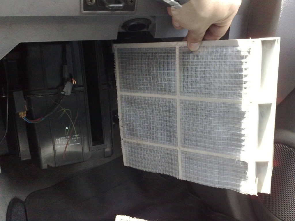

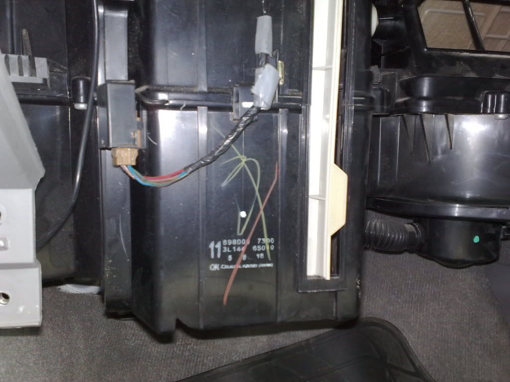

    Hey guys, going back to the aircon filter issue, here's my answer to it.
    Went to an aircon service shop and bought a window-type aircon filter from a busted aircon and had it cutted to the exact dimension of our max input slot and whoah! 'Got myself a custom-made air filter!
    Here's the pics...

    ^^ I thought you bought a whole window type aircon just to get the filter
    NICE NICE!! I'll do the same just in time for my 20k PMS also known as 'The Big One' hehehe.
    It still puzzles me why they didn't put in a filter for that thing very minor naman ang cost nito.
    Or maybe it's one of those trick challenges
    Feb 2007
    106
    #3899
    Haha! Actually that was my old busted aircon bought by the service center as they can still use some of its good parts. They were simply too happy to give me the filter and installed it for 200 bucks--in 15 min In your case maybe, you'll have to buy a whole new one
