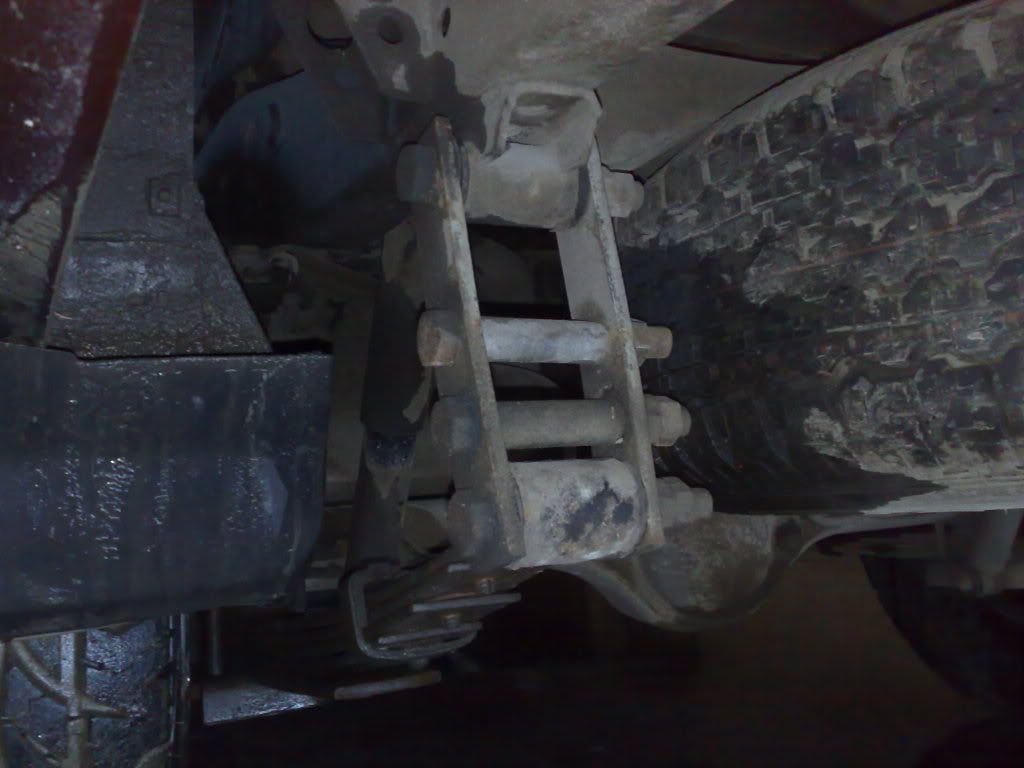

    hi xxadonisxx,
    can you also send a picture of the hanger on the rear "muelye" and what do you mean by: "adjusted the torsion bar to lift the front face".
    Sorry, it looks like I'm asking you an "upgrade kit/procedures for increasing dmax height at a minimum cost"
    this is a picture of the leaf spring hanger, note that as you can see, multiple bolts were placed to strengthen the hanger against bending and shear. because thrice a week i carry home 18 cavans (the maximum load capacity is 20 for 1 ton but i only load 18 so to not stress the car) of rice from my work in bocaue back home in my house in novaliches.. that is also a reason why the rear end of my car is a little higher than the front end of my car so that when i load the rice, my car would'nt look like an airplane trying to take off.

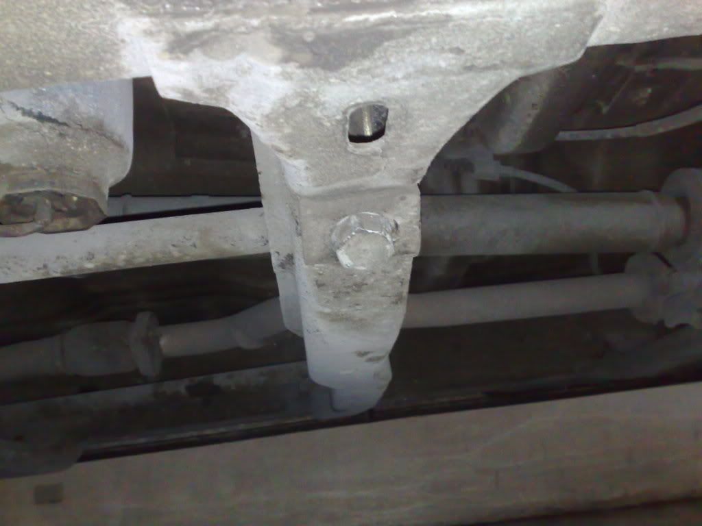

    and this is the picture of the torsion bar and the nut to be adjusted, it is located at the middle of the vehicle.
    to other fellow dmax ownes, as you can see in the picture, the underside of my dmax needs a rust proofing very badly... where can you sugest a good rustproofing service here in metro manila? is a 3m undercoat good enough? or a service from "savi" or "ziebart" provides a good service?
