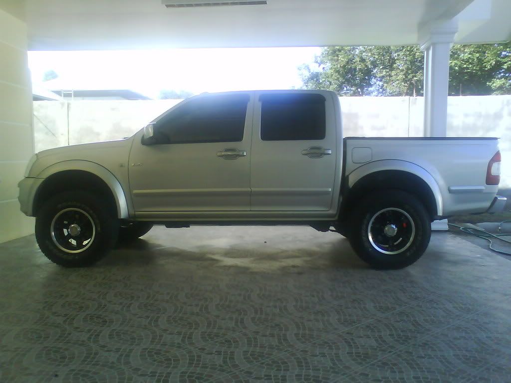

    I'm getting larger ones too. Dunlop Grandtrek AT3s, 265/70 R16 which means it will slightly lift the truck since it's a larger diameter tire.
    Sir Memphs, di ba dapat yung 265 is the tire width so yung series ang dapat mas mataas para mag-increase ang ride height (i.e. 265/75 R16)?
    3,722
    #3715
    Yes that's right, 75 is taller than 70 but then I found that too bulky/heavy na when I fitted it at first so that's why I stuck with the 70. As you will observe...
    the 265/70R16 profile is already very large. In fact we had to cut(!) some body work at the front wheel wells to give way and then up the torsion by a few clicks and then I had to get longer shackles for the rear springs.
    So now the truck is about 2.5 - 3 inches taller na due to the adjustments. Very happy with the set-up

    Hey Memphs, ok na ok ang tindig ah! I noticed you also removed the mud guards
    3,722
    #3717
    ^^^ Ah oo. Actually I was forced to remove the front ones because it would be eaten alive by the tires so I also had to remove the rear set para match :lolabove:
    Ah ok. So the lift is due to the torsion & shackle adjustments to accomodate the larger diameter tires. How's the ride now, softer or bouncier or just the same?
    3,790
    #3719
    memphis, ano ang outside diameter ng gulong na yan?
    3,722
    #3720
    Quote Originally Posted by isketi View Post
    I forgot to mention nga pala that prior to this, I had my last 2 leafs sa leaf pack inverted which greatly improved the ride - softer na! I tried inverting the last (shortest) leaf at first then tested the ride which wasn't really that much of an improvement that's why I went for the double inversion.
    With the new tires, there was a further improvement and I believe that the softer sidewalls of the Dunlops really helps because it flexes so much better than our stock ones. Tigas pala ng stock tires!
    Big improvement talaga sa ride because of these changes
