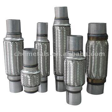

    Palagyan mo lang yan ng flexible tubing wala na yang problem mo. Yung sa akin XTO A/T buhat ng malagyan ng flexible tubing ay tumino na. Walang kagalawgalaw yung tambutso. Daig pa yung gas fed engine. Dami yan sa Evangelista, Makati.

    yup yup all you need is a flexible tube exhaust pipe to solve the problem...
    kunin mo yung mahaba...pag maliit parang wala karin ginawa...
    too much vibration kasi sa engine kaya yung exhaust...nababaliw sa nginiig...hehe
    lagay mo to after the exhaust manifold bandang ibaba before the muffler

    Hmm... will try that, have done it on my car before, but didn't really want to touch the X-Wind exhaust (no gains in power from exhaust work, hehe). Sige nga, puntahan ko nga yung suki kong muffler shop. :D

    magkano kaya yung long na flexible connector? bugbog sarado na sa welding yung exhaust manifold ko.
