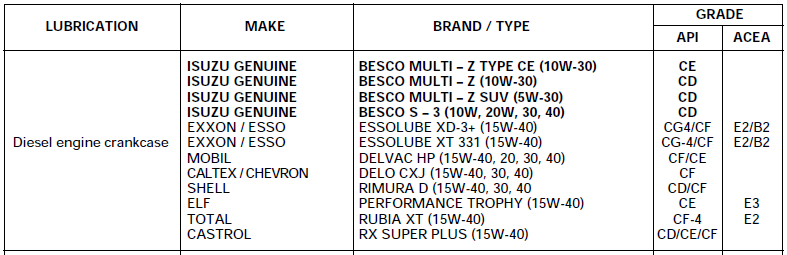

August 16th, 2010 10:50 AM #121Hmm... now that's different, to the best of my knowledge, 5W30 is the one that is supposed to be used. I wonder if its because with the replaced injectors it can now use 10W30? Calling on the more experienced 4JX1 owners here!

August 20th, 2010 06:35 PM #126hello everyone,
what is the engine of a 2001 isuzu trooper 4x2 bought in Isuzu Cavite? Is it the 4JX1 also?
Thank you
August 20th, 2010 08:53 PM #127
You can check that by looking at the engine number at the identification plate somewhere at the engine bay or the engine # indicated in the Certificate of Registration.
But if that is a locally sold (purchased) ISUZU Trooper, I am almost 100% sure that is a 4JX1 engine. (since I believe 4JX1 engines started since '99/'00 until the Trooper's last production.
..... unless, the precious owner replaced the engine prior to your purchase with a 4JG2.

August 20th, 2010 11:47 PM #129the one i bought is 1999 model isuzu trooper local not 2000 as i first stated the with the type of engine i saw the bill from isuzu cavite service it says that the engine is 4jx1. but the CR stated that the OR is dated july 28,2003 does this mean its,s been acquired 2003? the oil they use is also multi z 10w 30
