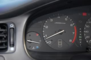

    Quote Originally Posted by diorel View Post
    normal lang ung mataas na rpm at cold start. sakin nasa 1.5K rpm. this eases the engine to reach its normal temperature. upon reaching its normal O.T., a few minutes, your idle should be stable at 900 (line before 1K rpm). just don't know if its 900..some say its 750 or 800.
    check ko idle ko this morning nasa 1,5k din sir pag cold start pareho tayo sir,atleast alam ko na normal lang yun,salamat naman so far wala na ako problem sa accord ko kundi yung vss na lang,hanap nalang ako sa banawe or makati this week siguro,yung radiator ko pala pina convert ko na sa tanso ung pang ilalim kasi fiber glass lang pala un,tumagas na ang tubig ko buti naagapan ko agad,salamt sa mga tips sir
