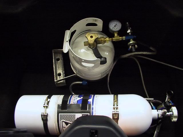

    Your basic set-up
    High pressure regulator if you want a big jump in power, economy and emissions so low they always got to test it twice
    Standard LPG regulator slight bump in power, better economy, no more black smoke.
    High pressure hose, A good 1/4" ID hose rated for LPG will do, Many hydraulic shops carry it. You can find a wide variety of hoses to pick from.
    Solenoid valve. This controls when the system is on or off.
    Boost pressure switch, or Digital progressive controller based on boost. (I carry these) but you can find a simple pressure switch at most parts stores.
    You'll need a variety of fittings to make it all work. I prefer high end brass or nickel plated brass push lock connectors with hose.
    This is a example of a LPG kit.
    For something like a Pajero or Crosswind you only need 0.5psi to 2psi of LPG remember this is fumigation your not putting liquid lpg in your engine.
    I run 8psi of it because my water injection keeps my combustion temps way down, but for a standard vehicle 0.5psi to 2psi of LPG is more than enough. You can feel it come one you will pick up speed without using extra throttle.
    This needs to be set up by someone who knows what they are doing because you can damage your engine with a improper set up, You will know your spraying to much because the engine will sound like a box of rocks in it. I could not run over 5psi lpg with my water injection off.
    I have all the stuff when I get back to do a full progressively controlled or boost activated kit. Only thing you need is a LPG tank and a tank mount. I don't fear my tank in the back, you can drop those things off a 5 story building and they will be fine. 10 times stronger than any gas on a car.
    It's amazing to me that in a land of LPG you guys don't run this. I get a 4psi boost just from my LPG coming on when I am at 100kph and it comes on the van goes to 120 without giving it more throttle and keeps going so you got to keep backing off, It's a blast to drive.
    On my systems I put the solenoid valve at the front of the vehicle for quicker response and you don't have bleed down from all the lpg still left in your line.
