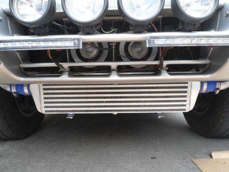

    so far ang pinaka malaking effect at ramdam ko na mods na ginawa ko ay changing the intercooler and putting springs to delay the wastegate from opening full...
