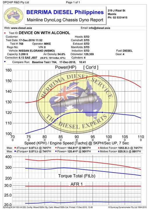

    Alcohol injection can can you as much as a Chip so it's a matter of budget and if you mind filling a tank from time to time. Chips are around 35000p
    Example Dchip Strada 3.2 common rail. Gain 26.7hp
    Alcohol Injection on my 3.2 Elgrand electro mechanical injection This was just with a 3gph nozzle using around 30% rubbing alcohol, Gain 34.6
    So which the Chip it depends on the setting, With the alcohol injection it depends on nozzle size and alcohol percentage plus adding boost will give you even more power..

    Doc isnt your air-fuel ratio too high?
    Dec 2007
    1,961
    #120
    I don't know if the AFR was even reading on that run since it's just flat lined , The air/fuel ratios for diesel engines under full load are between 17:1 and 29:1,
